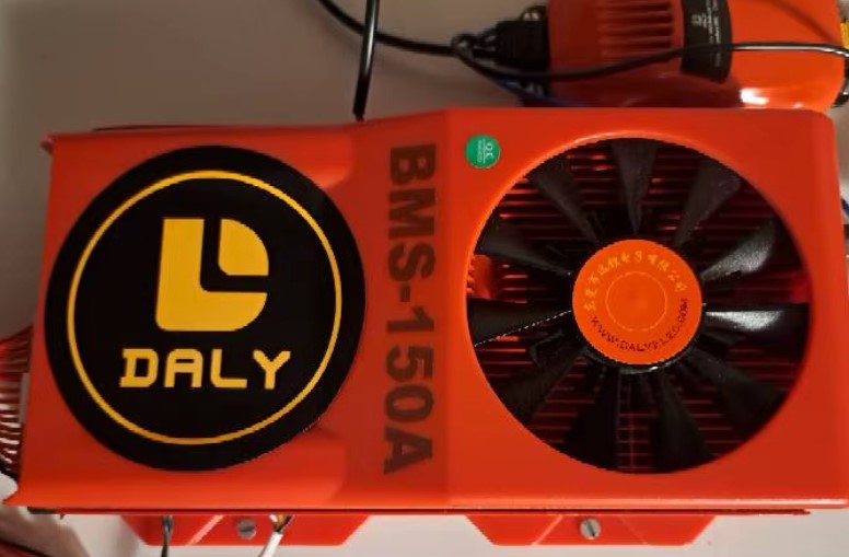

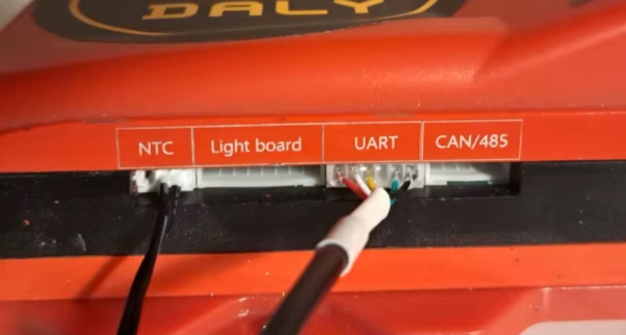

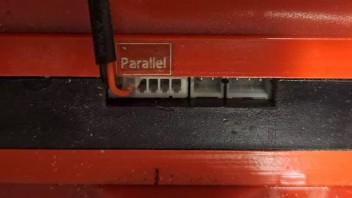

  • I have an energy storage consisting of two 48V 200Ah LFP packages connected in parallel, each of which is managed by a Daly 16S 150A S series BMS. BMS-ST103-309E hardware version, 11_220211_277E software. It is an extended version of the BMS equipped with a DIO parallel port for parallel module control. It also has UART and CAN/485 ports. As Daly does not mark BMS variants anywhere, I attach photos for easier identification.
    I have access to the BMS so far through BT communication modules and the Smart BMS application. Everything works reasonably correctly.
    However, I wanted to access the BMS via BT+wifi modules and Comboard modules dedicated to older versions of BMS. And the problems began. BT+wifi modules work only in local BT mode. In remote wifi mode, the Smart BMS app shows the online connection, but no data is displayed.

  • Hello,
    This is not a Daly S-Series, but most likely a U-Series with a fan. I generally refer to it as the "Classic-Series."
    With this type, compatibility with the Daly Bluetooth/WiFi transceiver is generally critical, because specific hardware requirements must be met. Simply updating the firmware is not sufficient. Daly should be aware of this, which is why I'm surprised that they sent you supposedly problem-solving firmware. I don't expect you'll be able to get the BMS working satisfactorily with WiFi.
